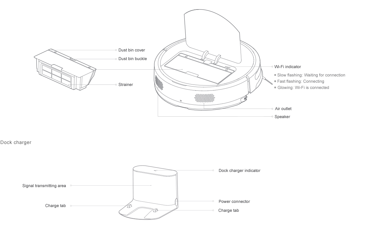

| Unable to charge | The dock charger is not plugged in. Please confirm the two ends of the power cable are properly plugged.
               Contact is poor. Please clean the contact tab on the dock charger and the charging contact on the machine. Please confirm whether the charging indicator is on.  |
| Unable to recharge | There are too many obstacles near the dock charger. Please place it in an open area.
               The machine is too far from the dock charger. Please put it near the dock charger.  |

| Cleaning capacity decreased or dust dropped out | The dust bin is full. Please empty it.
               The strainer is blocked. Please clean it. The main brush is stuck with foreign matters. Please clean them off.  |
